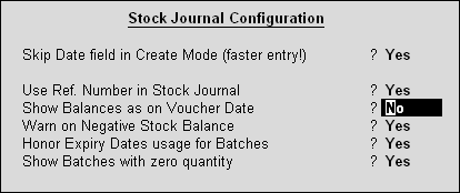

Enter the reference number, if any, or leave it blank.
Note: To get the reference column in the Stock Journal, in F12: Configuration screen set Yes to Use Ref. Number in Stock Journal.

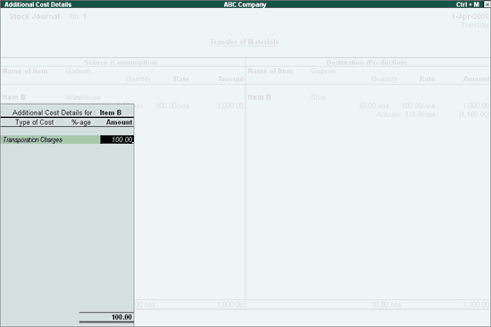

When there are some Additional Cost/Expenses incurred, then you can account the same in the Stock Journal.
After mentioning the quantity, rate and amount under Destination (Production), the ‘Additional Cost Details’ screen will be displayed. Enter the additional cost/expense incurred.
Note: To get the additional cost details in the Stock Journal voucher, enable Track additional costs of Purchase in F11: Features: F2: Inventory Features.
