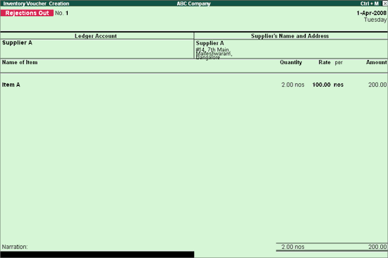

For example, the company returns Item A received from Supplier A.
Ledger Account
Select the Party’s name from the List of Ledger Accounts, to whom you are returning the goods.
Supplier’s Name and Address
Once Party’s name is selected under Ledger Account, this column will be filled up automatically with the address, if provided in the Ledger Master creation screen.

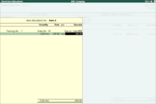

Name of Item
Select the Item from the List of Stock Items. Press Enter on the Item, it will display the Item Allocations screen.
Under the List of Tracking Numbers, the details of Receipt note along with Tracking number will be displayed, Select the same and mention the quantity rejected.
Narration
Give the narration, if required.
