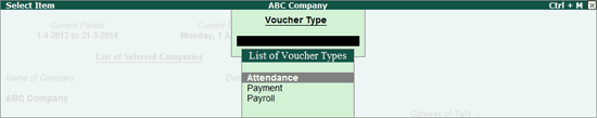

To view the existing Voucher Types in Tally.ERP 9 payroll,
Go to Gateway of Tally > Payroll Info. > Voucher Types > Alter
The List of the Voucher Types is displayed, you can chose the required Voucher Type and Alter the same to create the Voucher Class as per your requirement.
You can press Enter on the required Voucher Types to create new Voucher Class.
