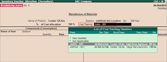

Record the Transaction in Manufacturing Journal
Go to Gateway of Tally > Inventory Vouchers > F7: Stock Journal
  1. In Change Voucher Type screen select Manufacturing Journal from the List of Types.
  2. Enter the Date as 24-10-2010
  3. In Name of Product select the Finished Goods which is manufactured. E.g. Cooker 12Litre
  4. Application skips the BoM Name field as bill of Material is not created for the stock item
  5. In Godown field select the godown where the finished goods manufactured will be stored. ABC Company stores all the manufactured goods in JobWork (In) Location.
  6. In Quantity field specify the quantity of goods manufactured. E.g 300.
  7. In Cost Tracking field select the Cost Tracking Number towards which you want to track the cost of Manufacture. Here ABC Company is tracking the cost towards JobIn - 001.
Note: Cost Tracking field will be displayed in Manufacturing Journal for the Finished Goods selected for which Enable Cost tracking is set to Yes.
