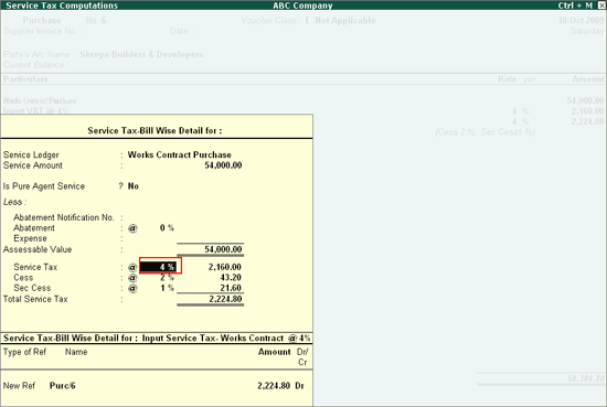

  9. Under Particulars select Input Service Tax- Works Contract  @ 4% and press enter to view Service Tax Bill Details screen.
  10. In Service Tax Bill Details screen - in Service Tax field enter the applicable rate of Service Tax (instead of Default rate of service tax).
In the present Example we have taken 4.12% as the Rate of Service Tax. Service Tax Bill Details is displayed as shown
  1. Accept the Service Tax Bill Details screen
  2. In the TDS Nature of Payment Details screen, accept the default details.

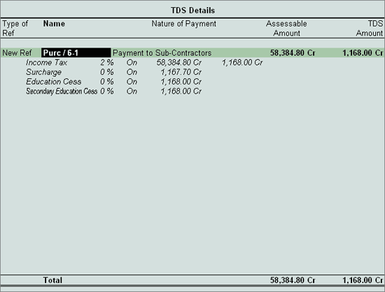

  3. Under Particulars select TDS- Works Contracts and press enter to view TDS Details screen.
  4. In TDS Details screen
  5. select the Type of Ref as New Ref
  6. In Name field select the default Bill Name - Purc-6/1
  7. In Nature of Payment field select Payment to Sub-Contractors
  8. Assessable Value and TDS Amount will be displayed automatically
Note: TDS will be calculated on the total amount of Rs. 58384.80 (Purchase cost of Works Contract + VAT + Service Tax)

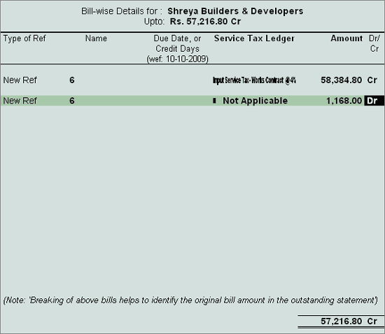

  1. Press enter to accept the TDS Details scree
  2. In the Bill-wise Details enter the details as shown
Completed Purchase Voucher screen is displayed as shown
