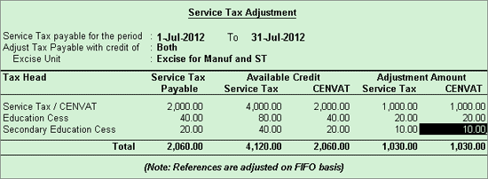

  4. Click S: Service Tax Helper button or press Alt+S, the Service Tax Adjustment screen will appear
In this screen,
  • Enter the from and to date of the period in which you have service tax payable in the Service Tax payable for the period field
  • Select the option Both in the Adjust Tax Payable with credit of field
  • A new field called Excise Unit appears when CENVAT or Both is selected in Adjust Tax Payable with credit of field.
  • Select the Godown or Unit for which the input credit is availed in the Excise Unit field
The helper will automatically compute the tax payable for the mentioned period and adjust it towards the available CENVAT and Service Tax Input Credit.
  • Accept this screen
The completed Journal voucher is shown below:
  • Press Enter to accept the voucher
