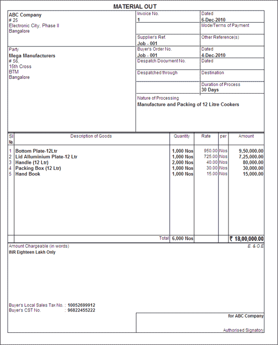

Step 2: Generate Annexure II
Material are transfered to Job Worker along with Annexure II. In Tally.ERP 9 users can generate Annexure II (Material Transfer Out Challan) from Material Out Voucher.
To print Annexure II
  • Press PageUp to go back to Material Out voucher entry
  • Click on Print button or press Alt + P from the Material Out voucher to view the Voucher Printing screen
  • Press 12: Configure to view Material Out Printing Configuration screen
  • Set the option Print as Annexure II to Yes
Completed Material Out Printing Configuration
Note: To view the Annexure II in a preview mode, click on I: With Preview button or press Alt + I.
  • Press Enter to accept the Voucher Printing sub screen and to display the Annexure II in Print Preview mode.
  • Click Zoom or Press Alt+Z to view Annexure II
The Print Preview of Annexure II is displayed as shown
In Annexure II, To be filled by the Processing Factory in Original & Duplicate Chalaln section will be filled by the Job worker and returned to the Principal Manufacturer along with the Finished Goods.
If the Principal Manufacturer has agreed for delivery of Finished goods in installments, then Job worker has to mention the date and time of delivery each installment and return the Annexure II when the last installment is delivered.
