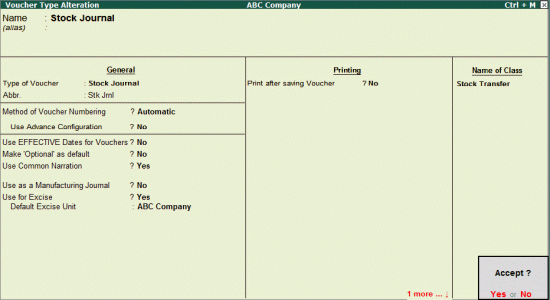

To create an excise stock journal,
  1. Go to Gateway of Tally > Accounts Info. > Voucher Types > Alter > Stock Journal
  2. Enable the option Use for Excise and select the dealer unit as the Default Excise Unit It will only display Excise Units which are configured with Registration Type as “Dealer” (If required a screen can be shown to activate the option) Enter the Name of the Class

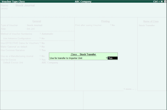

  1. Press Enter to display the Voucher Type Class screen
  2. Enable the option Use for transfer to Import Unit
  1. Press Enter to accept
The completed Voucher Type Alteration screen appears as shown below:

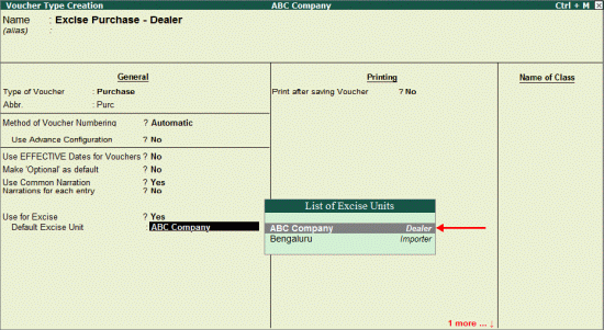

Excise Purchase Voucher Type – Dealer Unit
To create an excise purchase voucher type,
  1. Go to Gateway of Tally > Accounts Info. > Voucher Types > Create
  2. Enter the name of voucher type
  3. In the Type of Voucher option select Purchase
  4. Enable the option Use for Excise
  5. Select the dealer unit as the Default Excise Unit

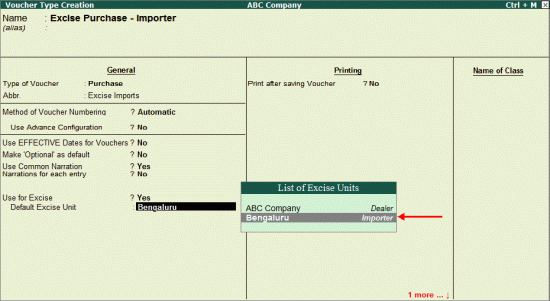

Excise Purchase Voucher Type – Importer Unit
  5. Select the importer unit as the Default Excise Unit

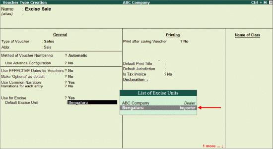

To create an excise sales voucher type for sale of goods from importer unit,
  1. Go to Gateway of Tally Accounts Info. Voucher Types Create
  3. In the Type of Voucher option select Sales

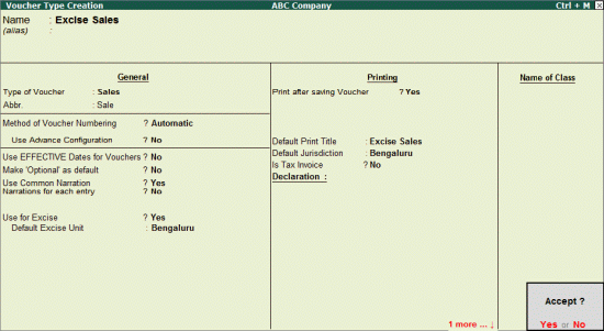

  1. Enable the option Print after saving Voucher
  2. Disable the option Is Tax Invoice
The completed Voucher Type Creation screen appears as shown below:

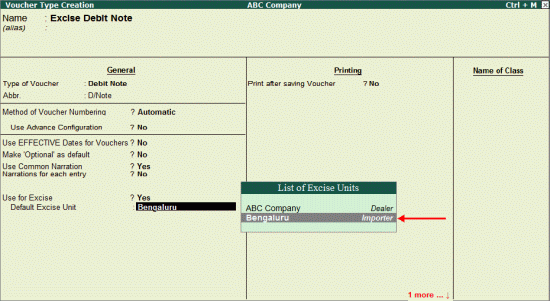

Excise Debit Note
The purchase returns have to be made against the unit where goods were stored using debit note voucher type predefined with the respective excise unit.
To create an excise debit note voucher type to account for purchase returns against importer unit,
  3. In the Type of Voucher option select Debit Note

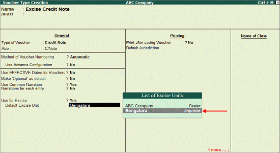

Excise Credit Note
The sales returns have to be made against the unit from which goods were cleared using credit note voucher type predefined with the respective excise unit.
To create an excise credit note voucher type to account for sales returns against importer unit,
  3. In the Type of Voucher option select Credit Note
