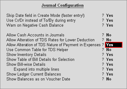

In F12: Configure (Journal Configuration)
  • Set Allow Alteration of TDS Nature of Payment in Expenses to Yes

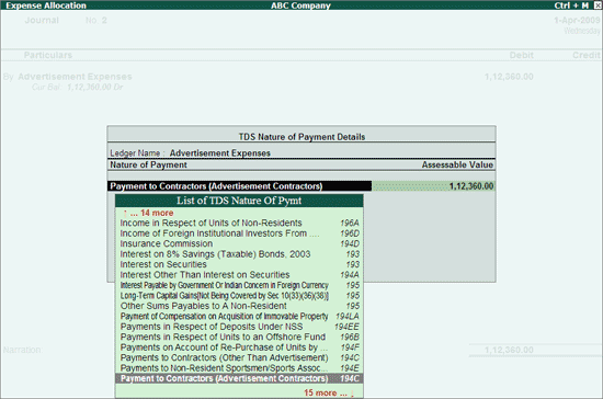

  4. The Expense Allocation -  TDS Nature of Payment Details screen is displayed.
Note: When Allow Alteration of Nature of Payment in Expenses is set to Yes in F12: Voucher Entry Configuration, Tally.ERP 9 facilitates Assigning/ Altering Nature of Payments and Assessable value of the Expenses during voucher entry.
The TDS Nature of Payment Details screen displays the Nature of Payment and the Assessable Value of the expenditure.
  • Press Enter to accept Payment to Contractors (Advertisement Contractors) as Nature of Payment.

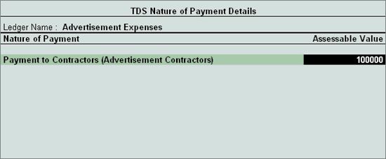

  • The amount in the Assessable Value is defaulted to Rs. 1,12,360. Enter Rs.1,00,000 in Assessable Value field and press Enter.
Note: Assessable Value is the amount on which the TDS will be computed. In the above transaction the Bill amount of Rs. 1,12,360 includes other expenses of Rs 12,360 on which the Tax cannot be deducted. Thus assessable value is arrived at by deducting Service tax from the Bill amount
Bill amount (1,12,360)–other expenses (12,360) = Assessable Value (1,00,000)

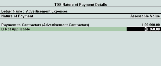

  • In the Nature of Payment field select Not Applicable from the List of TDS Nature of Payment (balance amount of Rs 12,360 gets allocated automatically in the Assessable value field)

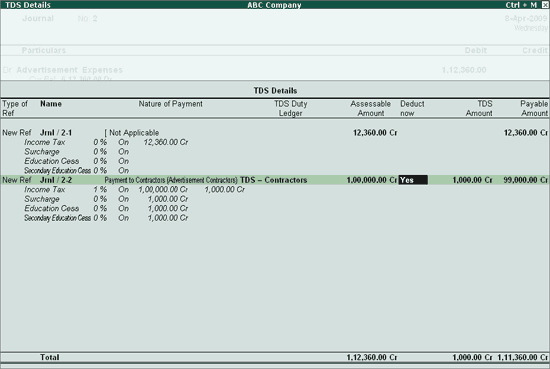

  2. In TDS Details screen
  • In Type of Ref field select New Ref from the Method of Adjustment.
  • In Name field accept the default reference number – Jurl / 2-1.
  • In Nature of Payment field select Not Applicable from the List of Nature of Pymt(s).
  • In the Assessable Amount field, the amount selected as Not Applicable in the TDS Nature of Payment Details will be dafaulted.
  • In Name field accept the default reference number – Jurl / 2-2.
  • In Nature of Payment field select Payments to Contractors (Advertisement Contractors) from the List of Nature of Pymt(s).
  • Select TDS – Contractors in the TDS Duty Ledger field.
  • In the Assessable Amount field, the amount as specified in the TDS Nature of Payment Details against the expenses ledger will be defaulted.
  • Set Deduct now field to Yes.
  • TDS Amount field displays the Tax Deducted at Source.
  • Payable Amount field displays the amount (after TDS) payable to the Party.
Note: The amount of Rs.12,360, on which TDS is Not Applicable is shown separately and is not considered for TDS calculation.

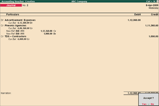

  1. In the Credit field select TDS - Contractor from the List of Ledger Accounts.
  2. In the Amount field, Rs. 1000 [Bill amount (1,12,360) - Pending Amount (1,11,360)] is displayed automatically.
  3. Enter Narration, if required.
  1. Press Enter to accept and save.
