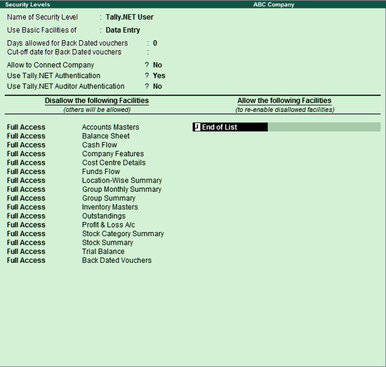

To create security controls for a Tally.NET User, execute the following steps:
Go to Gateway of Tally > Alt+F3 > security Control > Types of Security
  1. In the Security Levels for company screen, select Tally.NET User.
  2. In the Security Levels for Tally.NET User screen.
    • By default, Tally.NET User appears in the Name of Security Level field.
    • By default, Data Entry appears in the Use Basic Facilities of field, the system administrator can change this based on the requirement.
    • Type 0 in Days allowed for Back Dated vouchers
    • The Cut-off date for Back Dated Vouchers is left blank
    • Allow to Connect Company is set to Yes if the system administrator wants the required security level to connect the company for remote access to Tally.NET Server.
    • By default, Use Tally.NET Authentication is set to Yes. The user classified under this security level can login remotely with Tally.NET User capabilities. However, the user having auditor’s license will not be able to perform an audit using the Tally.NET User Authentication.
    • By default, Use Tally.NET Auditor Authentication is set to No.
    • In Disallow the following Facilities
    • Select the required Access Control from the Type of Access
    • Select the required Report / Activity that you want to disallow based on the access control that from the List of Reports
    • In Allow the following Facilities
    • Select the End of List from the Type of Access
  1. Press Enter to save the access controls for Tally.NET User.
