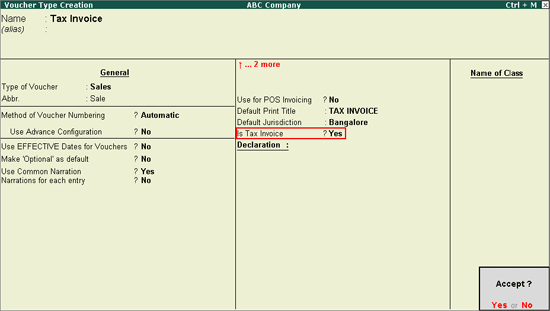

Go to Gateway of Tally > Accounts Info. > Voucher Types > Create
  • Enter the Name of the Voucher Type, for e.g., Tax Invoice
  • Select the Type of Voucher, for e.g., Sales from the List of Voucher Types
  • In the Abbr. field, you may abbreviate the voucher type as per your requirement or retain the same
  • Select the Method of Voucher Numbering as Automatic
  • Set Print after saving Voucher to Yes or No as applicable
  • Enter the Default Print Title as TAX INVOICE
  • Enter the Default Jurisdiction as Bangalore
  • Set the field Is Tax Invoice to Yes
  • Press Y or Enter to accept the Tax Invoice
Note: In the sales voucher type, only when the option Is Tax Invoice is set to Yes, the invoice can be printed as a Tax Invoice.
