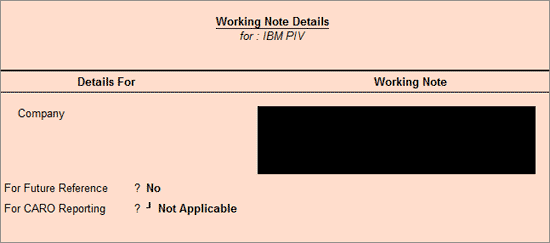

Click on W: Working Note or press Alt+W to specify the working note details at Company or Stock Group or Stock Item level. The details provided in working note will be captured in Audit Working Paper along with the details of User Name, Working Note Date & Time, Status, Note etc.
In Working Note Details screen
  • Details for: In this field select the level for which Working Note to be entered.
  • Company: On selection of Company as the Level cursor will move to Working Note field to enter the details.

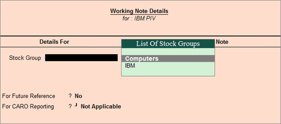

  • Stock Group: On selection of Stock Group based on the ledger selected, displays the list of Groups for defining the Working Note

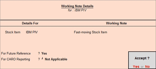

  • Stock Item : Selection of level - Stock Item, application will default the stock item for which the Working Note to be entered.
  • Working Note: In this field enter the working note details
  • For CARO Reporting?:Choose the clause applicable to the Working Note from the list of CARO Clauses displayed. Working Notes tagged with CARO Clauses will appear in the CARO Working Paper.
  • For Future Reference?: By default this option will be set to No. Set the option to Yes, to carry the Working Note forward to the next audit period. That is, the Working Note details will be displayed in Audit Working Paper of Current as well as Next Audit Period.

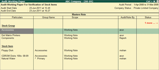

Ctrl+W: Audit Wkg Paper
To view the Audit Working Paper during Auditing, click on Ctrl+W: Audit Wkg Paper or press Ctrl+W. The details displayed in Audit Working Paper will be relevant to report from where it is triggered.
For more details on Working Paper refer the topic  Working Paper
