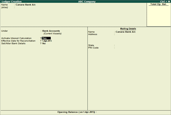

Go to Gateway of Tally > Accounts Info. > Ledger > Create
Ensure the option - use advanced parameters below Activate Interest Calculation of F11: Features > F1: Accounts is set to No.
Create the ledger Canara Bank A/c by grouping it under Bank Accounts and set the option - Activate Interest Calculation to Yes.

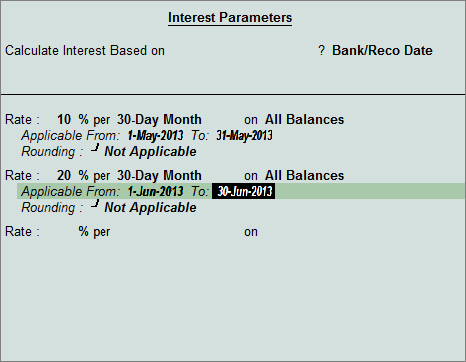

In the Interest Parameters screen, select the Bank/Reco Date as the Date Type in the Calculate Interest Based on field. Provide the other parameters as shown and accept the Interest Parameters and the bank Ledger Creation screen:

In the Ledger Alteration screen of Canara Bank A/c ledger, set the option - Activate Interest Calculation to Yes and press Enter key. In the Interest Parameters screen, select the Bank/Reco Date as the Date Type in the Calculate Interest Based on field. Provide the other parameters as shown and accept the Interest Parameters and the bank Ledger Creation screen:

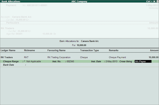

Click F12: Configure and set the option - Use Single Entry mode for Pymt/Rcpt/Contra to Yes and accept the Voucher Configuration screen. Record the payment voucher and provide the bank details.

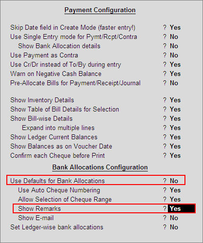

Note: To provide bank details with remarks, click F12: Configure in the Payment voucher and set the options as shown:
The Payment voucher appears as shown:

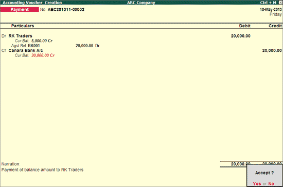

Recording payment Voucher in Double Entry Mode

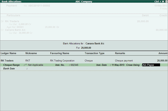

In the Accounting Voucher Creation screen, click F12: Configure and set the option - Use Single Entry mode for Pymt/Rcpt/Contra to No and accept the Voucher Configuration screen. Record the payment voucher and provide bank details.

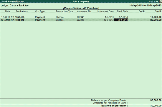

To reconcile the payment voucher, go to Gateway of Tally > Banking > Bank Reconciliation > Canara Bank A/c
For the payment vouchers recorded in the previous section, enter the reconciliation dates as shown and accept the Bank Reconciliation screen:

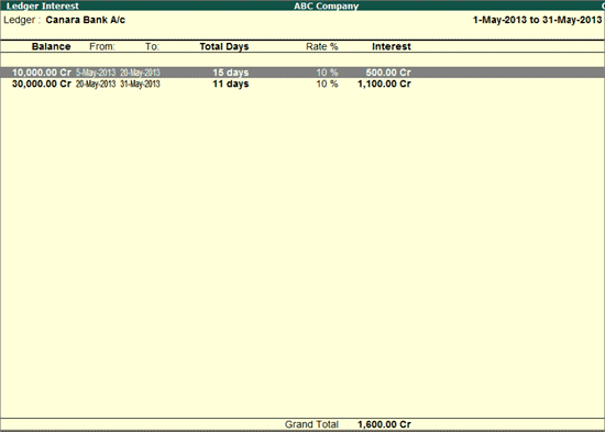

To view the Interest Calculation report after reconciling the payment vouchers, go to Gateway of Tally > Display > Statement of Accounts > Interest Calculation > Ledger > Canara Bank A/C
Click F2: Period and enter the From and To dates as 1-5-2013 and 31-5-2013 respectively. The Interest Ledger report appears as shown:
Depending on the dates entered for reconciliation, the interest gets calculated and displayed here.

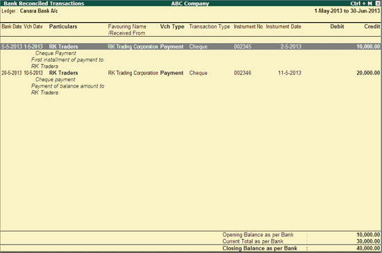

Bank Reconciled Transactions
To view the Bank Reconciled Transactions report, press Enter on any one of the balances displayed in the Ledger Interest report.
(Go to Gateway of Tally > Display > Statement of Accounts > Interest Calculation > Ledger > Canara Bank A/C > Press Enter on any one of the balances)

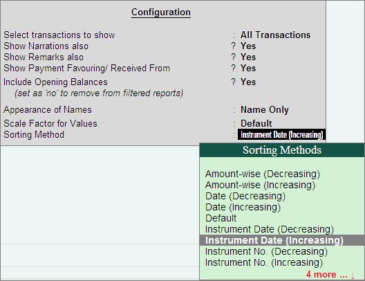

Click F2: Period and change the From and To dates as 1-5-2013 to 30-6-2013 respectively. Click F12: Configure and set the options as shown to choose the required sorting option and capture the narration, remarks and favouring name in the Bank Reconciled Transactions report:
The Bank Reconciled Transactions report appears as shown below:
The Bank Reconciled Transactions report provides columnar details on reconciled transactions. The description of each column is given below:
Bank Date: The Bank Date provided in the Bank Reconciliation screen is captured here.
Vch Date: The date on which the transaction is recorded is captured here.
Particulars: The remarks and narration entered in the payment/receipt voucher are captured under the name of the ledger:
  • Debited while recording a payment transaction.
  • Credited while recording a receipt voucher.
Favouring Name/Received From: The details entered in the Favouring Name/Received From field in the Bank Allocation screen of payment/receipt voucher is captured here.
Note: To provide details in these field, ensure the relevant information is provided in the Bank Details (displayed on setting the option - Provide Bank Details to Yes) in the party ledger master.
Vch Type: The voucher type used to record transaction is captured here.
Transaction Type: The transaction type selected in the Bank Allocations screen of the payment or receipt voucher is captured here.
Instrument No.: The instrument number entered in the payment or receipt voucher is captured here.
Instrument Date: The instrument date entered in the payment or receipt voucher is captured here.
Debit: The amount debited to the bank ledger in the voucher is captured here.
Credit: The amount credited to the bank ledger in the voucher is captured here.
