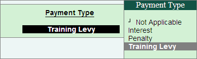

  3. Select Training Levy Payable ledger. Select the Payment Type as Training Levy and enter the ledger balance amount.

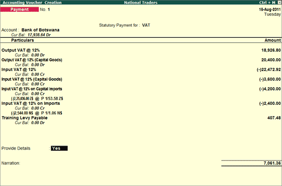

Go to Gateway of Tally > Accounting Vouchers > F5: Payment
Press F12: Configure button and ensure that Use Single Entry mode for Pymt/Rcpt/Contra is set to Yes
In the Payment voucher screen,
  1. Click the Stat Payment button or press Alt + S to display the Statutory Payment sub-screen.
  2. In Statutory Payment sub-screen, provide the details given below:
  3. Type of Duty/Tax: Select VAT as the payment is being made towards VAT dues.
  4. Auto Fill Statutory Payment: Set it to Yes to automate display of tax payable amount.
  5. Adjust Input VAT for Payment: This field gets displayed only when - Auto Fill Statutory Payment is enabled. On setting this field to Yes, the tax payable amount gets calculated by offsetting output tax against the available tax credit.
  6. Period From: Enter the return period in From and To fields.
Note: The tax payable is auto-calculated and displayed in payment voucher on:
(i) Paying only the output VAT amount using Statutory Payment button by setting Auto Fill Statutory Payment to Yes and Adjust Input VAT for Payment to No
(ii) Setting options - Auto Fill Statutory Payment and Adjust Input VAT for Payment to Yes when there is balance amount remaining after offsetting tax credit.
  1. In the Payment Voucher, select the Bank ledger in Account field (use Crtl+A key combination and create a bank ledger grouped under Bank Accounts).
  2. In the Payment Voucher, the output and Input tax amount will be automatically set-off and the tax payable amount gets calculated and displayed. The input VAT amount will be displayed with negative sign to set-off against output VAT.
  1. Set Provide Details to Yes to display the VAT Payment Details screen.
  1. In the VAT Payment Details screen, enter the payment details.
  1. Press Enter to accept the VAT Payment Details screen.
  2. In the Bank Allocations screen, enter the name in whose favour the cheque is being issued under Favouring Name. Enter the Cheque number and Cross Instrument Using details
  1. Accept the payment voucher.
