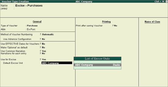

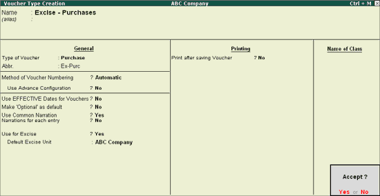

Creating Purchase Voucher Type
To create the Purchase Voucher Type,
  1. Go to Gateway of Tally > Accounts Info. > Voucher Type > Create
  2. Enter the name of the Voucher type in Name Field e.g. Excise - Purchases
  3. Select Purchase as the voucher type in Type of Voucher Field
  4. You may abbreviate the Voucher type as per your requirement e.g. Ex-Purc
  5. Select the appropriate Method of Voucher Numbering
  6. Set Use Advanced Configuration to Yes to specify the numbering method, if required
  7. Set Use for Excise to Yes to enter Excise Purchase to capture Assessable Value and Excise Duty breakup
  8. In Default Excise Unit select ABC Company from the List of Excise Units
  1. Set Print after saving Voucher to No
  1. Press Enter to accept and save
Note: The Use for Excise option will appear in Purchase/Debit Note and Sales/Credit Note only and if the Excise feature is enabled in the F11 Feature > F3 – Statutory & Taxation.

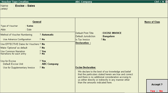

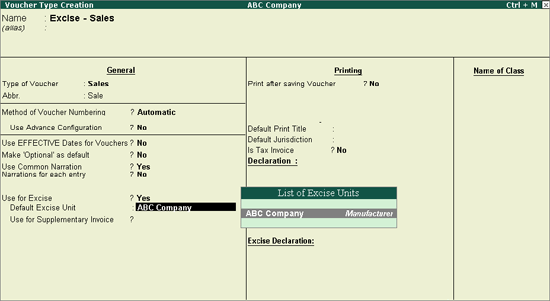

Creating Sales Voucher Type
To create the Sales Voucher Type,
  2. Enter the name of the Voucher type in Name Field. E.g. Excise - Sales
  3. Select Sales as the voucher type in Type of Voucher Field
  4. You may abbreviate the Voucher type as per your requirement. E.g. Ex- Sales
  1. Set Use for Excise to Yes to enter Excise Purchase to capture Assessable Value and Excise Duty breakup
  2. In Default Excise Unit select ABC Company from the List of Excise Units
  1. Set Print after saving Voucher to Yes
  2. Enter the print title of the Voucher type in the Default Print Title field e.g. EXCISE INVOICE
  3. Set No to Is Tax Invoice
  4. Specify the declaration, if any
