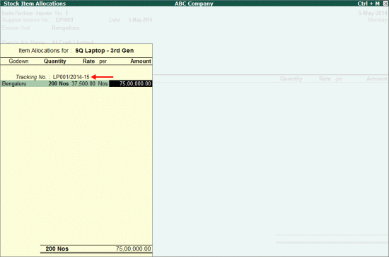

  4. Select the stock item and in the Stock Item Allocation screen,
  5. Enter the Tracking Number (ensure the option Use Tracking Numbers is enabled in F11: Inventory Features) as the goods are being cleared partially. Tracking number can be set to Not Applicable if all the goods imported are cleared at once
  6. Select the importer unit, enter the quantity and rate as shown below:
