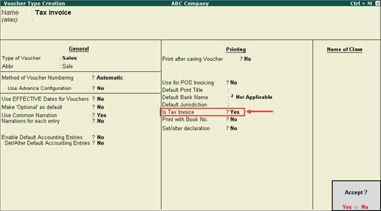

To create a tax invoice voucher type
1.     Go to Gateway of Tally > Accounts Info. > Voucher Types > Create.
2.     Enter the Name of the voucher type.
3.     Select Sales as the Type of Voucher.
4.     Set the option Is Tax Invoice? to Yes.
The Voucher Type Creation screen appears as shown below:
5.     Press Enter to accept.
