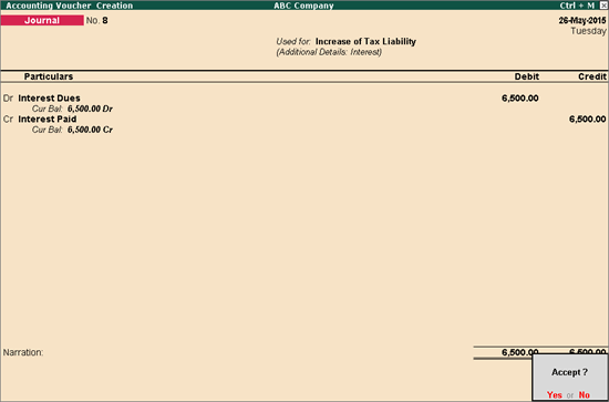

To record journal entry to account for interest payable
1.     Go to Gateway of Tally > Accounting Vouchers > F7: Journal.
2.     Click J: Stat Adjustment to view the Stat Adjustment Details screen.
3.     Press Enter to return to voucher.
4.     Debit an expense ledger created under Indirect Expenses with option Is VAT/CST Applicable? set to Not Applicable.
5.     Credit the ledger created under Current Liabilities. The completed screen appears as shown below:
6.     Press Enter to save.
