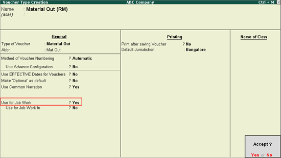

1. Voucher Type - Material Out (RM)
This voucher Type will be used by the Principal Manufacturer in Job Work Out process for recording the Transfer of Raw Materials to the Job Worker.
To create the voucher type
Go to Gateway of Tally > Accounts Info. > Voucher Types > Create
  • In Name field enter the name of the Voucher Type. E.g. Material Out (RM)
  • In Type of Voucher field select Material Out from the List of Voucher Types
  • Select Automatic in Method of Voucher Numbering field
  •  Retain the default setting for other options
  • Set the option Use for Job Work to Yes
Note:
1. Use for Job Work option will be displayed in Material Out voucher type when the option Allow Job Order Processing is set to Yes in F11: Features (Inventory Features).
2. Set the option Use for Job Work to Yes if you want to use the voucher type to record Job work transactions.
  • Retain No for the option Use for Job Work In
  • Set Print after saving Voucher to No
  • Enter Default Jurisdiction as Bangalore
Note: Set the option Use for Job Work In to Yes if the Job Worker wants to use the Material Out voucher type to record the transfer (out) of Finished goods/ scrap/ Co-product/By-Products.
The completed Voucher Type Creation screen is displayed as shown:
  • Press Enter to save

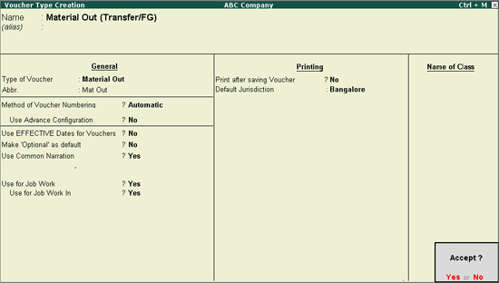

2. Voucher Type - Material Out (Transfer/FG)
This voucher Type will be used by the Job Worker in Job Work In process for recording the Transfer of Finished Goods, Scrap, By-Products, Co-Products to the Principal Manufacturer.
To create the voucher type,
  • In Name field enter the name of the Voucher Type. E.g. Material Out (Transfer/FG)
  • Set the option Use for Job Work In to Yes

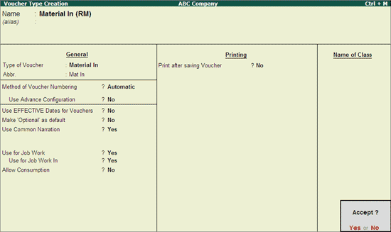

3. Voucher Type - Material In (RM)
This voucher Type will be used by the Job Worker in Job Work In process for recording the Receipt of Raw Materials from the Principal Manufacturer.
  • In Name field enter the name of the Voucher Type. E.g. Material In (RM)
  • In Type of Voucher field select Material In from the List of Voucher Types
The completed Voucher Type Creation is displayed as shown:
Note: While creating Job Work In voucher type to account the receipt of Raw Materials by the Job worker, if the option Use Job work In is set to Yes Tally.ERP 9 will skip Allow Consumption field.

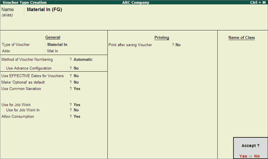

4. Voucher Type - Material In (FG)
This voucher Type will be used by the Principal Manufacturer in Job Work Out process for recording the Receipt of Finished Goods, Scrap, By-Products, Co-Products from the Job Worker.
  • In Name field enter the name of the Voucher Type. E.g. Material In (FG)
  • Set the option Use for Job Work In to No
  • Set the option Allow Consumption to Yes
Note:
1. Enable the option Allow Consumption in Material In voucher types, when the voucher type is used by the Principal Manufacturer to account the receipt of Finished Goods from the Job Worker.
2. When Allow Consumption is set to Yes, on recording the Material In voucher the Raw Materials used in the manufacture of Finished goods will be considered as Consumed and to that extent the stock will be reduced from the books of accounts.

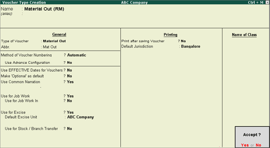

Create Material In/out Voucher Types - if Excise Applicable
  • Set the option Use for Excise to Yes
  • In Default Excise Unit field select the Excise unit - ABC Company
Similarly, create all the Material Out/In voucher type if excise applicable.
