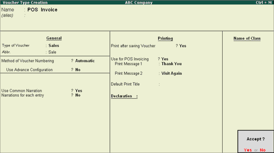

To enable POS Invoicing in Tally.ERP 9. create a POS Invoice Voucher Type. You may also alter an existing Sales voucher type for this feature to be enabled.
Go to Gateway of Tally > Accounts Info > Voucher Type > Create
Name: Enter the name of the Voucher type (for e.g.: POS Invoice).
Type of Voucher: Select the type of Voucher as Sales from the predefined Voucher Types.
Abbreviation: By default, Sales text will appear in the abbreviation field.  However, you can enter the abbreviation as per your requirements
Used for POS Invoicing?: On selecting the Sales voucher type from the list, Used for POS Invoicing? Option appears, set this option to Yes
Print Message 1 and Print Message 2: These two additional fields for messages appear on enabling the above POS feature, which can used for custom messages viz., *Thank You* or *Visit Again* and so on as per your requirements. The same will be printed at the bottom of the POS invoice.
Default Print Title: You can specify the printing title of the POS Invoice and the same will be printed in the Invoice.
