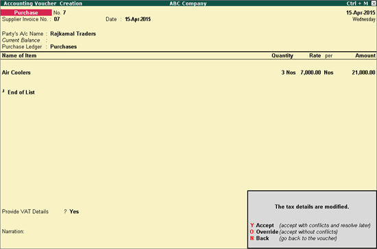

6.     Select the required stock item. Enter Quantity and Rate. The purchase invoice appears as shown below:
7.     Press O to consider the nature of transaction selected in the invoice and save.

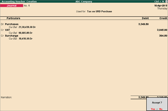

Journal Entry to account for Tax on purchase from URD
To create tax liability on purchase from unregistered dealers
1.     Go to Gateway of Tally > Accounting Vouchers > F7: Journal.
2.     Click J: Stat Adjustment to enable the required options in the Stat Adjustment Details screen.
3.     Debit the expense ledger.
4.     Enter the amount.
5.     Credit the VAT ledger. Enter the VAT Details as shown below:
6.     Credit the surcharge ledger and enter the VAT Details. The journal voucher appears as shown below:
7.     Press Enter to save.
