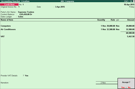

1.     Go to Gateway of Tally > Accounting Vouchers > Crl+F8: Credit Note.
2.     Enter the Original Invoice No. of sales invoice against which credit note is recorded.
3.     Select the required Party’s A/c Name from the List of Ledger Accounts.
5.     Select the common sales ledger.
6.     Select the required taxable stock item.
7.     Enter the Quantity and Rate.
8.     Select the common VAT ledger.
9.     Set the option Provide VAT Details to Yes.

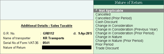

10.  Enter the sales details and select the Nature of Return as Not Applicable to account for sales returns as shown below:
If the credit note is being recorded for any other purpose, select the relevant Nature of Return.
11.  Select the required Nature of Return, and press Enter. The credit note appears as shown below:
12.  Press Enter to save.
