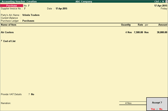

To record a purchase transaction from URDs
1.     Go to Gateway of Tally > Accounting Vouchers > F9: Purchases.
2.     Click F12: Configure and enable the relevant option.
3.     Enter the Supplier Invoice No. and Date if any.
4.     Select the supplier ledger in Party’s A/c Name field.
5.     Select a common purchase ledger in which the option Is VAT/CST Applicable is set to Applicable, and Set/Alter VAT Details is disabled.
o      Select Purchase From Unregistered Dealer as Classification / Nature in the VAT Classifications Details screen.
o      Press Enter to save.
6.     Select the required stock item. Enter Quantity and Rate. The purchase invoice appears as shown below:
7.     Press Enter to save.

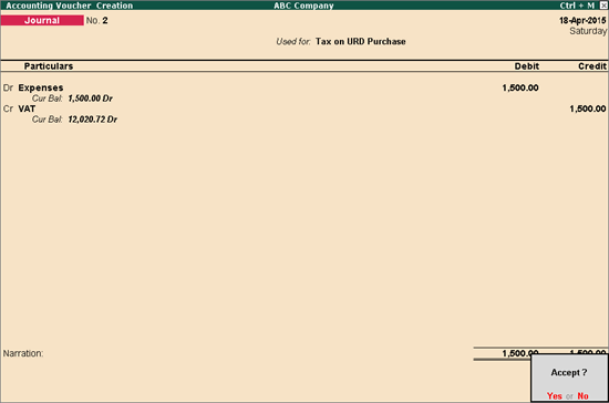

Journal Entry to account for Tax on purchase from URD
To create tax liability on purchase from unregistered dealers
1.     Go to Gateway of Tally > Accounting Vouchers > F7: Journal.
2.     Click J: Stat Adjustment to enable the required options in the Stat Adjustment Details screen.
3.     Debit the expense ledger.
4.     Enter the amount.
5.     Credit the VAT ledger.
6.     Enter the tax Rate, Assessable Value, Commodity name and Commodity Code for the purchase recorded. The journal voucher appears as shown below:
7.     Press Enter to accept.
