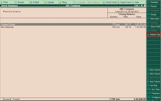

  • Go to Gateway of Tally > Stock Summary.
The Stock Summary report appears as shown below:
  • Click Godown Type button or press Ctrl+G.
Note: This button appears only when the option Maintain Multiple Godowns is enabled in F11:Inventory Features.

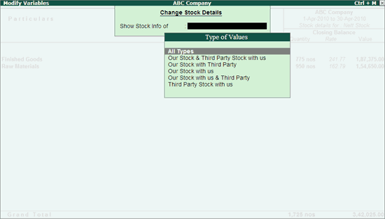

  • Select the stock details from the Type of Values list.
The Type of Values list appears as shown below:

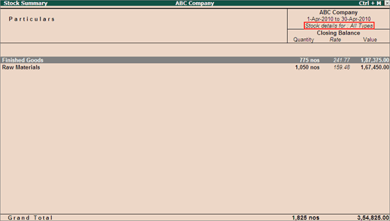

All Types
This report displays the stock including your stock lying with third parties and third parties stock lying with you, as shown:
  • Select the required Stock Group/Item to drill down for further details and other options as discussed in Displaying Stock Summary.

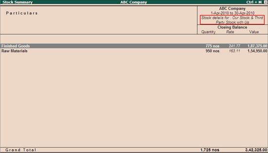

Our Stock & Third Party Stock with us
This report displays the stock including the third party stock lying with you, and excluding your stock with the third parties, as shown:

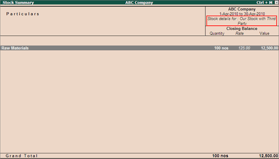

Our Stock with Third Party
This report displays your stock lying with the third parties, such as, Job workers, consignment agents, bonded warehouse, etc., as shown:

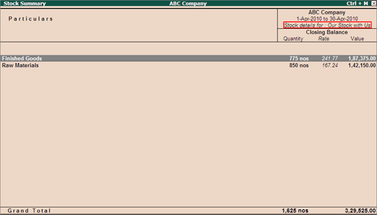

Our Stock with us
This report displays the stock after excluding your stock lying with third parties and the third party stock with you, as shown:
