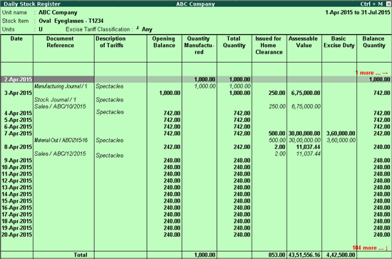

A registered manufacturer has to maintain duty details of finished goods in the form of a Daily Stock Registert.
To view the Daily Stock Register
  1. Go to Gateway of Tally > Display > Statutory Reports > Excise Reports > Manufacturer > Excise Registers.
  2. Click Daily Stock Register.
  3. Select the Name of the Excise Unit.
  4. Enter the period.
  5. Select the item required.
  6. Select the Tariff and Reporting Unit of Measurement.
  7. Press Enter.
You can view the stock item and the duty details for every day.
The report can be further configured to display more details from the Excise DSR Configuration screen.
