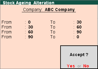

The Ageing Analysis report produces a default ageing period of <45 days, 45-90 days, 90-180 days and >180 days. Depending on requirement, the ageing slabs can be defined by you.

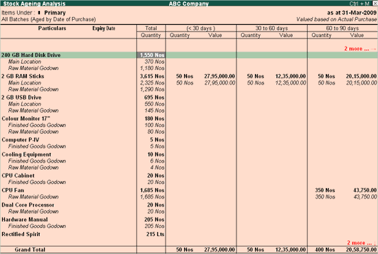

By default, the age of the items is ascertained from the date of purchase. You can change this by altering the configuration options. To define the ageing slab press F6.

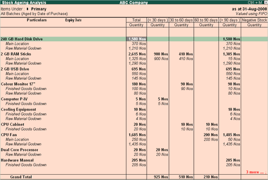

To get the value of the stock other than by the default method, press F7, and select from All Valuation Method for e.g. Avg Cost, Avg Price, FIFO, etc.
Item details valued using FIFO are displayed as shown below:

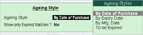

Different ageing styles provided in Tally.ERP 9 include purchase date, expiry date, manufacturing date etc. These are activated using the Alt + S: Ageing Style button.
You may define Ageing Style in four different ways:

Press Alt+S to invoke the Ageing Style menu.
Select By Date of Purchase as Ageing Style, the following screen is displayed.
