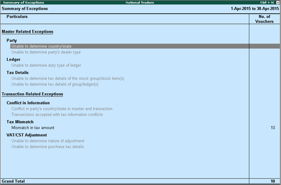

The Summary of Exceptions screen displays the count of transactions which are neither included nor excluded in the VAT form due to insufficient information.

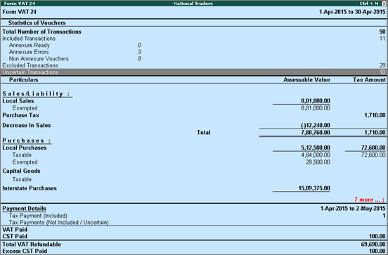

To view the Summary of Exceptions screen
1. Go to Gateway of Tally > Display > Statutory Reports > VAT > Form VAT 24.
2. Select Uncertain Transactions.
3. Press Enter.
The Summary of Exceptions screen appears as shown below:
