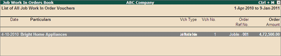

The details of Job Work In Order details can be viewed in
  • Job Work In Orders Book
  • Order Outstandings
To view the Job Work In Orders Book
Go to Gateway of Tally > Display > Job Work In Reports > Job Work Registers > Job Work In Orders Book
