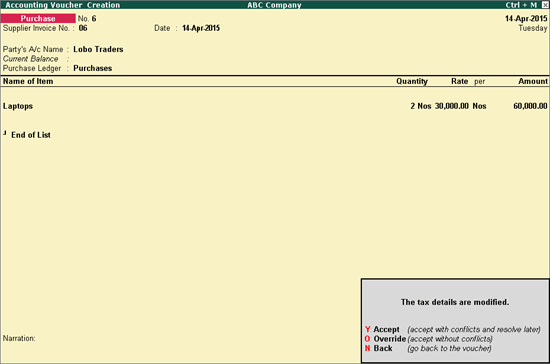

To record a purchase transaction from URDs
1.     Go to Gateway of Tally > Accounting Vouchers > F9: Purchases.
2.     Click F12: Configure and enable the relevant option.
3.     Enter the Supplier Invoice No. and Date if any.
4.     Select the party ledger in Party's A/c Name option.
5.     Select a common purchase ledger in which the option Is VAT/CST Applicable is set to Applicable, and Set/Alter VAT Details is disabled.
o      Select Purchase From Unregistered Dealer as Classification / Nature in the VAT Classifications Details screen.
o      Press Enter to save.
6.     Select the required stock item. Enter Quantity and Rate. The purchase invoice appears as shown below:
7.     Press O to consider the nature of transaction selected in the invoice and save.
