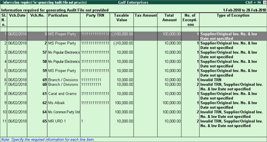

UAE VAT
Information required for generating Audit File not provided
Displays the number of transactions excluded from the audit file due to insufficient information.
Resolve the exception
1. Select Information required for generating Audit File not provided .
2. Press Enter to display Information required for generating Audit File not provided screen with the list of vouchers with mismatch/incomplete information.
3. Select any voucher and press Enter to display the Audit File Exceptions(s) screen, as shown below:
4. Enter the missing information or update the incorrect details, and press Enter to return to the Exception Resolution screen .
5. Select the next voucher to update the details required for audit file and continue.

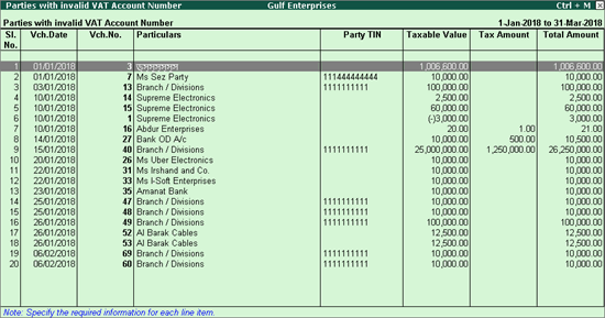

KSA VAT
Parties with invalid VAT Account Number
Displays the number of transactions excluded from the return due to invalid VAT account number for party ledgers.
1. Select Parties with invalid VAT Account Number .
2. Press Enter to display Exception Resolution screen with the list of vouchers with mismatch/incomplete information.
3. Select any voucher and press Enter to display the exceptions.
5. Select the next voucher to update the required details and continue.
