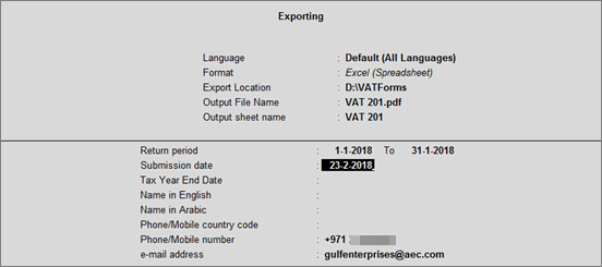

Export the VAT return
1. Go to Gateway of Tally > Display > Statutory Reports > VAT > VAT 201 .
2. Press Ctrl+E to export the e-return details to PDF in the format specified by the department. The Export Report screen appears as shown below:
3. Enter required details in Export Report screen.
4. Press Enter to export to PDF.

VAT Return Period
Displays the Return period shown in the Export Report screen while exporting the returns.
Tax Year End
Displays the Tax Year End Date recorded in the Export Report screen while exporting the returns.
VAT Return Due Date
Displays the VAT Return Due Date recorded in the Export Report screen while exporting the returns.

Name in English
Displays the name of the agency recorded in the field Name in English of Export Report screen while exporting the returns.
Name in Arabic
This field will be currently left blank.
Phone/Mobile country code
Displays the name of the agency recorded in the field Phone/Mobile country code of Export Report screen while exporting the returns.
Phone/Mobile number
Displays the name of the agency recorded in the field Phone/Mobile number of Export Report screen while exporting the returns.
Date of submission (dd/mm/yyyy)
Displays the name of the agency recorded in the field Submission date of Export Report screen while exporting the returns.
E-mail address
Displays the name of the agency recorded in the field e-mail address of Export Report screen while exporting the returns.
