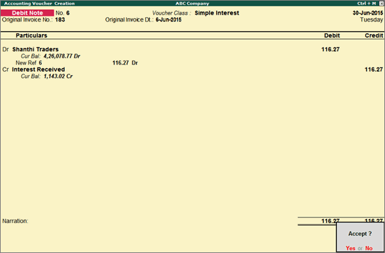

1. Go to Gateway of Tally > Accounting Voucher > Crtl+F9 : Debit Note . > select Simple Interest from Voucher Class List .
2. Debit the Party ledger.

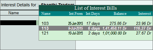

o Select the bills to adjust from the List of Interest Bills in the Interest Details screen.
o Press Enter .
3. Select New Ref in the Bill-wise Details screen.
4. Credit the ledger Interest Received grouped under Indirect Income .
The Accounting Voucher Creation screen appears as shown below:
5. Press Enter to save.

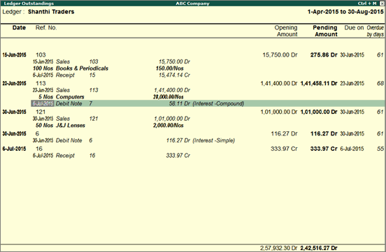

Entries for compound interest are exactly the same as simple interest where all you do is select the voucher class created for compound interest. Also the Bill-wise Details sub-screen is not displayed as the amounts are automatically added onto the bills.
The Ledger O utstandings appear as shown below:
The bill no. 113 is the invoice onto which interest has been compounded.
A new reference no 6 has been created for simple interest due from the party.
