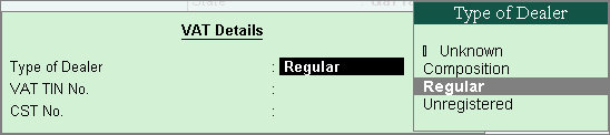

14. Enable the option Set/Alter VAT Details? . In the VAT Details screen,
1. Select the Type of Dealer from the Type of Dealer list as shown below:
Note:
♦ In case the Type of Dealer is selected as Regular and VAT TIN No. field is left blank, the warning message TIN is blank. is displayed.
