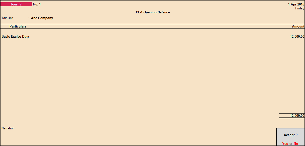

4.    To account opening balance of Basic Excise Duty, under Particulars select Basic Excise Duty @ 12.5%.
Note: While accounting PLA Opening Balance, in List of Ledger's only the Excise Type of ledgers will be displayed for selection.
5.    Amount: In this field enter the advance duty amount paid to the department. The completed PLA Opening BalanceJournal Voucher is displayed as shown below.

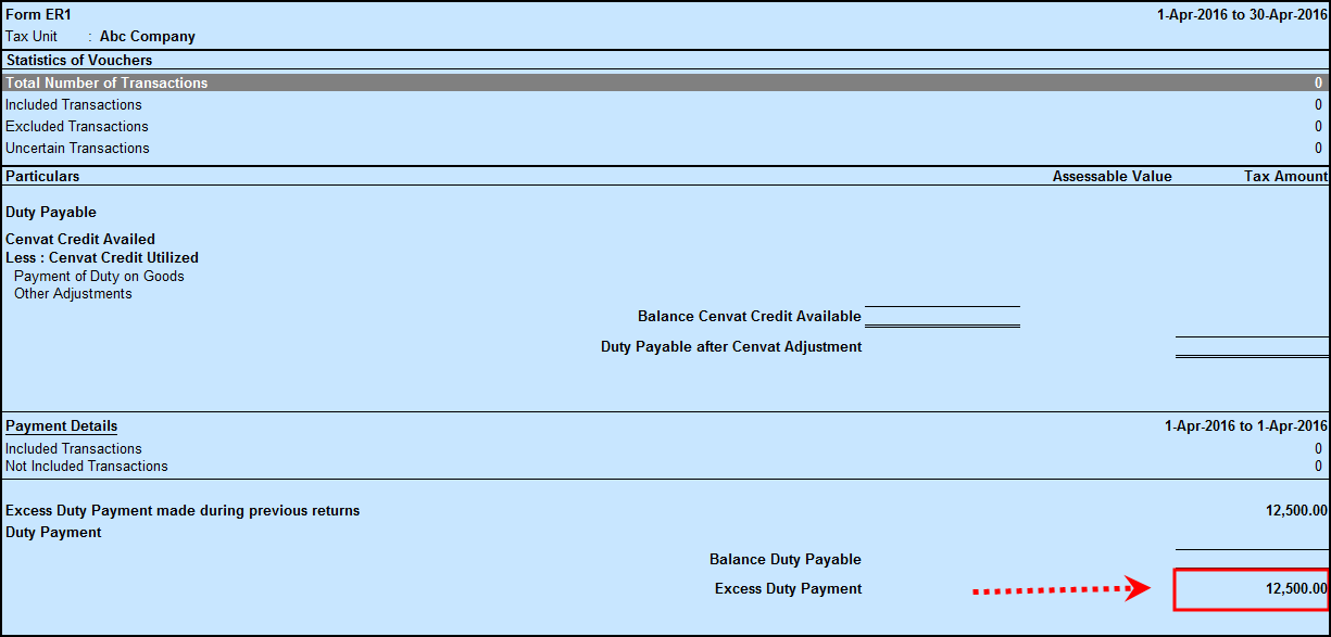

6.    Press Enter to save. The PLA Opening Balance entry will be displayed in Gateway of Tally > Display > Statutory Reports > Excise Reports > Manufacturer > Excise Forms > Form ER 1.
