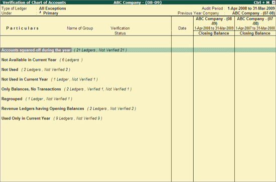

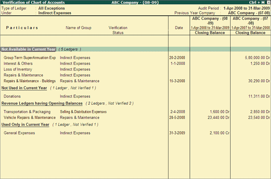

Verification of Chart of Accounts will help the Auditor to check the List of Accounts used during the Audit Year and compare the List of Accounts with the previous year. This report highlights all the exceptions in the Chart of Accounts and prompts the Auditor to concentrate only on the exceptional items.
To view the Verification of Chart of Accounts report
1.    Go to Gateway of Tally > Audit & Compliance > Audit & Analysis > Verification of Chart of Accounts.
Note: If the previous year (year before the Audit year) data is there in a different Company than it should be loaded before accessing this Verification of Chart of Accounts report for correct analysis.

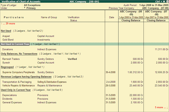

The Verification of Chart of Accounts report classifies and displays all the exceptional Ledgers (All Exceptions) along with the Ledger count and Verification count with the following Status:
Not Used
Ledgers which do not have any balance and have not been used in recording any transaction during both the years will be displayed under this status.
Not Used in Current Year
Ledgers which have been used for recording transactions only in the previous year, have no Closing Balance (from the previous year), and have no Opening Balance in the current year will be listed under this status.
Only Balances, No Transactions
Ledgers that have only Balances, but have not been used for recording transactions during both the years will be displayed under this status.
Regrouped
Ledgers for which the Primary Groups are different for the two years will be displayed under this status. Sub-group Level changes can be seen by using F12: Configure.
Revenue Ledgers having Opening Balances
Ledgers created under the P&L Group (e.g. Expenses, Income and so on.) and having Opening Balance will be listed under this status.
Used Only in Current Year
Ledgers (with or without Opening Balance) that have been used to record transactions only in the Current Year will be displayed under this status.
Not Available in Current Year
Ledgers that have been discontinued (not present) in the current year will be listed under this status.
Accounts squared-off during the year
Ledgers having transactions with accounts squared-off (nullified/adjusted) will be displayed under this status.
The other Status which can be viewed using the F12: Configure are:
All Items
Displays all Ledgers irrespective of the status.
No Change
Displays the Ledgers which have been used in both the Years.

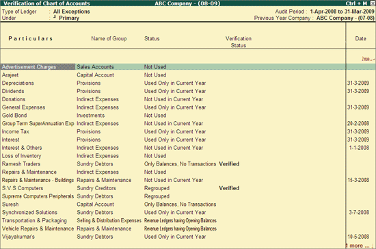

F1: Detailed
Click F1: Detailed or press Alt+F1 to view the list of Ledgers under each Status explained in the earlier section.

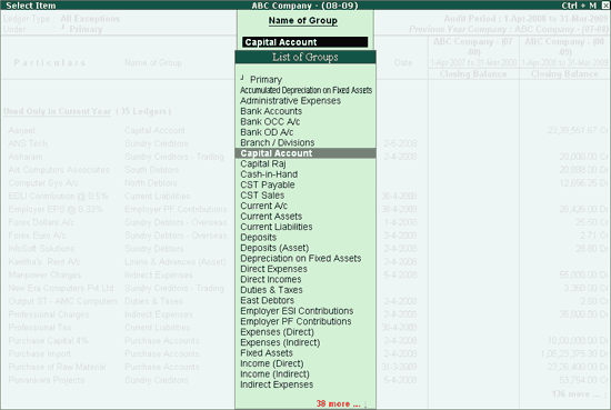

F4: Group
Click F4: Group or press F4 to filter for Ledgers belonging to a particular Group.
●     Select the required Group from the above screen and press Enter.

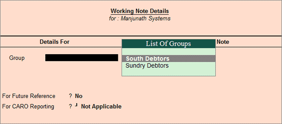

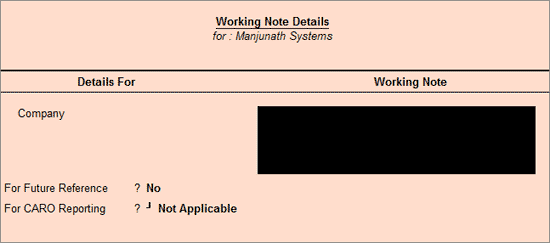

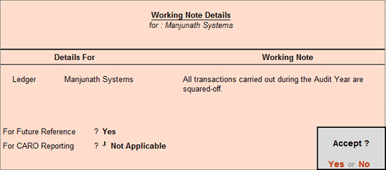

W: Audit Working Note
Click W: Audit Working Note or press Alt+W to specify the Working Note details at Company, Group, Ledger, Voucher levels. The details provided in Working Note will be captured in Audit Working Paper along with the details of User Name, Working Note Date & Time, Status, Note and so on.
●     Details for: In this field select the level for which Working Note to be entered.
●     Company: On selecting Company as the Level, the cursor will move to Working Note field.
●     Group: On selecting Group as the Level, a List of Groups (based on the Ledger selected) will be displayed for defining the Working Note.
●     Ledger: On selecting Ledger as the Level, the Ledger selected for creating the Working Note, will appear under Details For by default.
●     Working Note: In this field enter the Working Note details.
●     For CARO Reporting?:Choose the Clause applicable to the Working Note from the list of CARO Clauses displayed. Working Notes tagged with CARO Clauses will appear in the CARO Working Paper.
●     For Future Reference?: By default this option will be set to No. Set the option to Yes, to carry the Working Note forward to the next audit period. That is, the Working Note details will be displayed in Audit Working Paper of Current as well as Next Audit Period.

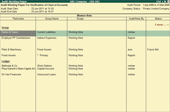

Ctrl+W: Audit Wkg Paper
To view the Audit Working Paper during Auditing, click on Ctrl+W: Audit Wkg Paper or press Ctrl+W. The details displayed in Audit Working Paper will be relevant to report from where it is triggered.
For more details on Working Paper refer the topic Audit Working Paper.

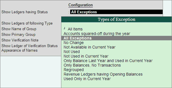

Click F12: Configure or press F12 to change the configuration for the displayed report.
●     Show Ledgers of Having Status: Select the required Types of Exception from the list to display the Ledgers belonging to the selected Status.

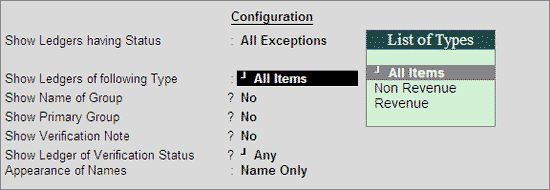

●     Show Ledgers of the following Type: Select to filter the information for Revenue Ledgers or Non Revenue Ledgers or both for the Types of Exception already selected.

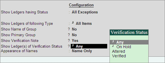

●     Show Ledger of Verification Status: Select to filter the information for On Hold Ledgers or Verified Ledgers or Altered Ledgers or Any for the Types of Exception already selected.

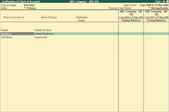

The facility to view the Ledgers belonging to a particular status is also provided by pressing Enter on the required Status form the Verification of Chart of Accounts report for All Exceptions.
The report for Ledgers Not Used in both years is displayed below:
The buttons available in the above report are similar to the buttons available under Verification of Chart of Accounts report for All Exceptions.
The Auditor can bring the cursor on the Ledger and click F8: Show Ledger or press F8 view the Ledger Vouchers report.
