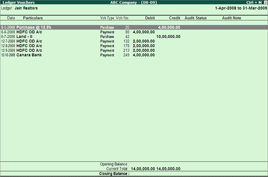

The Ledger Vouchers report for Ledgers used in the Current Year (Audit Year) displays all the transactions pertaining to the selected Ledger.
1.    Go to Gateway of Tally > Audit & Compliance > Audit & Analysis > Verification of Chart of Accounts.
2.    Select the required Exception Status and press Enter.
3.    Select the required Ledger and press F8 or click F8: Show Ledger.
Note: The Ledger Vouchers report will be available only for those Ledgers which are used in the Current Year.
The Ledger Vouchers report displays all the Vouchers with details such as Voucher Date, Vch Type, Vch No., Transaction Value, Audit Status and so on. The report also shows the Opening Balance, Current Total and Closing Balance for the selected Ledger.

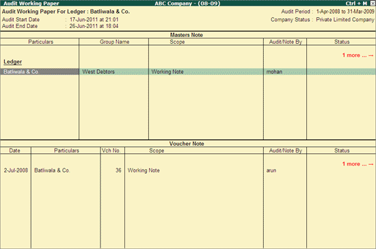

W: Working Note
Click W: Working Note or press Alt+W to specify the working note details at Company or Group or Ledger or Voucher Level. The details provided in working note will be captured in Audit Working Paper along  with the details of User Name, Working Note Date and Time, Status, Note and so on.
Ctrl+W: Audit Wkg Paper
Minute Level Audit Working Paper can be generated from Ledger Vouchers report for a Ledger with all types of notes, configurations (sampling/related party etc), Date and Time and so on. entered at different audit tools/ reports by different auditor(s)/article(s).
