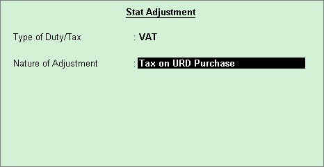

2.    Click J: Stat Adjustment. In the Stat Adjustment Details screen,
o     Select the option VAT in the Type of Duty/Tax field.
o     Select the option Tax on URD Purchase in the Nature of Adjustment field.
o     Press Enter to return to voucher.

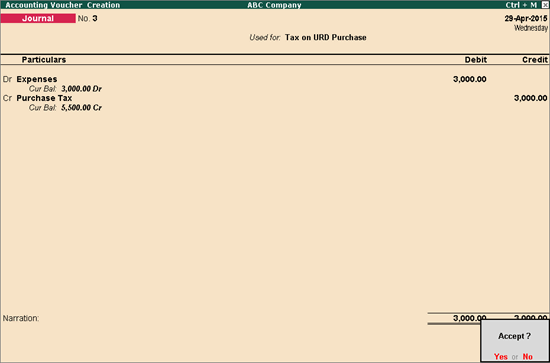

3.    Debit a ledger created under Indirect Expenses and enter the value in the Amount field.

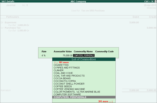

4.    Credit a VAT ledger created under Duties and Taxes by enabling the option Use for Purchase Tax? after selecting Type of duty/tax as VAT.
o     Enter the Rate and Assessable Value in the VAT Details screen.
    The completed screen appears as shown below:
5.    Press Enter to save.
