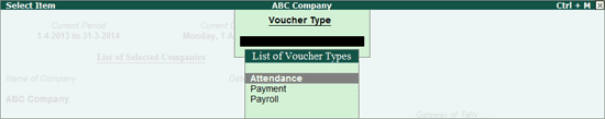

To view the existing Voucher Types in Tally.ERP 9 payroll
●     Go to Gateway of Tally > Payroll Info. > Voucher Types > Alter.
The List of Voucher Types appears, enabling you to chose the required voucher type. You can alter the same to create the voucher class as per your requirement.
You can press Enter on the required voucher types in the List of Voucher Types to create a new Voucher Class.
