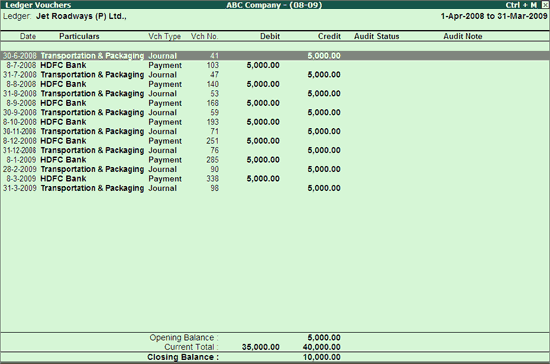

The Ledger Vouchers for the Repeated Transactions report displays those Vouchers for which the amount is repeated more than once.
1.    Go to Gateway of Tally > Audit & Compliance > Audit & Analysis > Repeated Transactions.
2.    Select the required Ledger and press Enter.
The Ledger Vouchers report displays the Vouchers for which the same amount is repeated along with the other required information like Voucher Date, Particulars, Voucher Type, Voucher Number, Dr and Cr Amounts, Audit Status and Audit Note.
