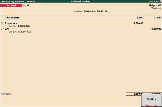

3.    Debit expense ledger and enter the amount field.
4.    Credit the VAT ledger. Enter the tax Rate, Addl.Rate, Assessable Value, Commodity Name and Commodity Code in the VAT Details screen, and press Enter. The journal voucher appears as shown below:
5.    Press Enter to save.
