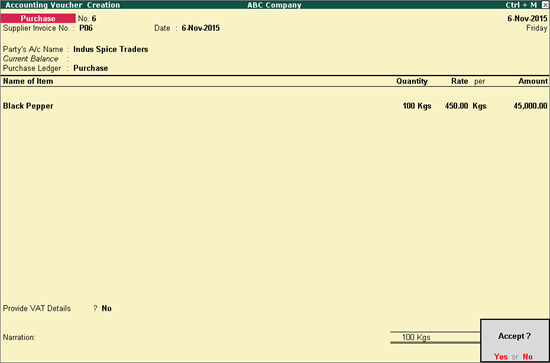

2.    Enter Supplier Invoice No. and Date.
3.    Select the party ledger in Party's A/c Name option.
4.    Select a common purchase ledger in which the option Is VAT/CST Applicable is set to Applicable, and Set/Alter VAT Details is disabled.
5.    Select Purchase Deemed Export as the Classification / Nature.
6.    Select the required stock items whose VAT rates are specified either at the stock group or stock item level. Enter Quantity and Rate for each stock item.

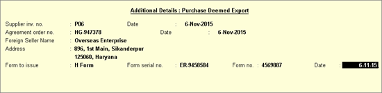

7.    Set the option Provide VAT Details to Yes to open Statutory Details screen.
o     Enter the H Form details in Additional Details sub-screen.
o     Press Enter to return to purchase invoice.
8.    Press Enter to save.
