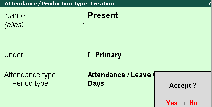

You can define Attendance/Production Types with or without pay.
●     Attendance/Leave with Pay: Use this to record the positive attendance and leave with pay (For example, Present, Sick Leave, and so on.)
●     Leave without Pay: Use this to record negative attendance (For example, Absent, Leave Without Pay, and so on.)
To record positive attendance type
1.    Go to Gateway of Tally > Payroll Info. > Attendance/Production Types > Create.
2.    Enter the Name of the attendance type.
3.    Select Primary from the list for the field Under.
4.    Select the Attendance type as Attendance/Leave with Pay. The Period type appears automatically.
5.    Press Enter to save.
Note: You can also create the Attendance Type Absent as Leave without Pay for recording negative attendance in the same manner.
