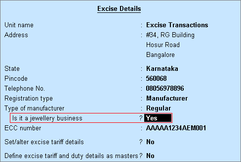

4.    In the Excise Registration screen, excise details like Unit name, Address, State, Pincode and, Telephone No. will be displayed as entered in the Company Creation screen. These details can be altered, if required.
5.    Select Manufacturer as the Registration type.
6.    Select the Type of manufacturer, as required.
7.    Enter ECC number.

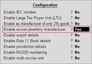

Note: For jewellery business, press F12: Configure.
8.    Enable the option Set/alter excise tariff details to Yes, to record tariff details.
