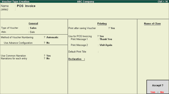

The Voucher Type Creation screen appears as shown below:
