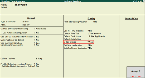

1.    Go to Gateway of Tally > Accounts Info. > Voucher Types > Create to open the Voucher Type Creation screen.
2.    Enter the Name of the voucher type.
3.    Select Sales as the Type of Voucher.
4.    Enter an abbreviation in the field Abbr., as required.
5.    Set the Method of Voucher Numbering? to Automatic.
6.    Enter Tax Invoice as the Default Print Title.
7.    Set the option Is Tax Invoice? to Yes.
The Voucher Type Creation screen appears as shown below:
8.    Press Enter to save the voucher type.
