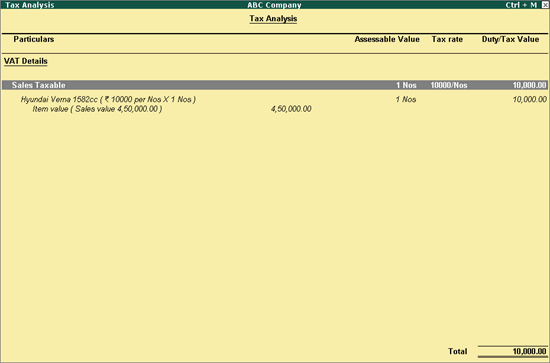

To record local sales of pre-owned cars
2.    Enter Ref number, if required.
3.    Select the party ledger in Party's A/c Name option.
4.    Select a common sales ledger in which the option Is VAT/CST Applicable is set to Applicable, and Set/Alter VAT Details is disabled.
5.    Select the required stock items (Pre-owned cars) with the following settings:
●     Calculation Type set as On Quantity.
●     Tax rate specified as 3,000 or 10,000 as per the engine capacity of the pre-owned car.
●     Tax type set as Taxable.
6.    Select the common VAT ledger.
7.    Click A: Tax Analysis to display the Tax Analysis screen.
8.    Click F1: Detailed to view the names of stock items. The Tax Analysis screen appears as shown below:
9.    Press Esc to return to tax invoice
The tax invoice appears as shown below:
10.  Press O to override.
