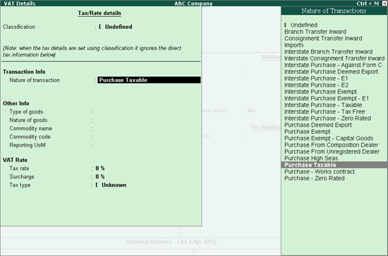

The VAT Details screen appears as shown below:
o     Press Enter to save the VAT Details screen.

The VAT Details screen with Local VAT rate appears as shown below:
