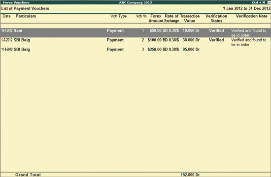

The Voucher Register report displays all the transactions for the selected Voucher Type including the Forex transactions.
To view the Voucher Register report
1.    Go to Gateway of Tally > Analysis & Verification > Verify > Forex Transactions.
o     Move the cursor to the Total Vouchers column for the required Voucher Type and press Enter.
The above report displays all the Vouchers for the selected Voucher Type along with the other details such as Voucher No., Forex Amount  and Rate of Exchange for the Forex Vouchers, Transaction value, Verification Status and Verification Note.

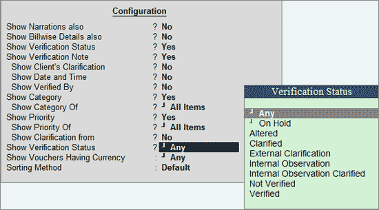

F12: Configure
Click F12: Configure or press on F12 to alter the default display for the above report.
     Show Narrations also: Set this option to Yes to display the Narration entered by the Client during the Voucher entry.
     Show Billwise Details also: Set this option to Yes to display the bill details entered during the voucher entry.
     Show Verification Status: Set this option to Yes to display the Verification Status as selected by the user during the Verification. This option is set to Yes by default.
     Show Verification Note: Set this option to Yes to display the Verification Note as entered by the user during the Verification. This option is set to Yes by default.
     Show Client's Clarification: Set this option to Yes to display the Clarification Note entered by the Client for the Vouchers marked as Need Clarification by the user.

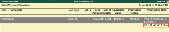

     Show Date and Time: Set this option to Yes to view the Verification Date and Time.
The Voucher Register is displayed as shown:
     Show Verification Status: Select the required Verification Status for vouchers (from Altered, Verified, Clarified, Need Clarification, Not Verified, Under Observation, On Hold and Any) to filter and display the vouchers for the selected Verification Status.
     Show Vouchers Having Currency: Select the required currency to filter and display the vouchers for the selected currency.
     Sorting Method: Select the appropriate method from the list of sorting methods.
