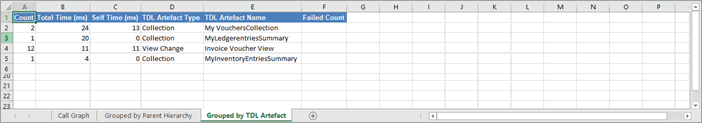

Grouped by TDL Artefacts
The data in this section is grouped by the TDL artefacts. Here each TDL artefact appears only once.
