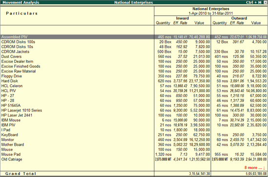

     Go to Movement Analysis report (Gateway of Tally > Display > Inventory Books > Movement Analysis > Stock Group Analysis > Primary) and select the period as 1 July 2016 to 30 June 2017. Click F5: Item wise.
o     Export the data to Excel format. Add a column in the Excel sheet to calculate the difference between inward and outward stock. This difference is the closing stock on which you can claim ITC once you sell the closing stock.

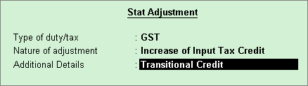

2.    Click J: Stat Adjustment.
o     In the Stat Adjustment Details screen, select the options as shown below:
o     Press Enter to save and return to the journal voucher.

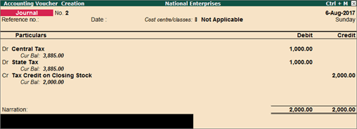

3.    To avail tax credit, debit the central tax and state tax ledgers, and credit the tax credit ledger grouped under Current Assets.
To avail tax credit on excise and service tax: Debit the central tax ledger and credit the service tax and CENVAT ledgers.
To avail tax credit on VAT, additional tax, cess, TDS and entry tax: debit the state tax/UT tax ledger and credit the VAT, additional tax, cess, TDS and entry tax ledgers.
